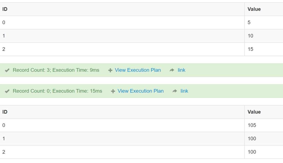

    Hocam senin icin iki adet sql fiddle hazirladim
    birincisindeki trigger sende isaret etmeye calistigim hatalarin oldugu sekilde
    CREATE TABLE [tbSample] (
      [ID] INT IDENTITY(0,1),
      [Value] INT);
      CREATE TRIGGER [trSample]
      ON [tbSample]
      AFTER UPDATE
      AS
      BEGIN
        DECLARE @dID INT
        DECLARE @dValue INT
        SELECT @dID = [ID] FROM INSERTED
        SELECT @dValue = [Value] FROM INSERTED
        UPDATE [tbSample]
        SET    [Value] = @dValue + 5
        WHERE  [ID] = @dID
      END;
    INSERT INTO [tbSample]([Value])
    VALUES (5), (10), (15);
    ikincisindeki trigger ise duzeltilmis hali
      [Value] INT);
      ON [tbSample]
      AFTER UPDATE
      AS
      BEGIN
        UPDATE [tbSample]
        SET    [Value] = [I].[Value] + 5
        FROM   [tbSample] [S]
        INNER JOIN INSERTED [I] ON [S].[ID] = [I].[ID]
      END;
    ikisinde de ayni asagidaki kodu calistiriyorum
    SELECT * FROM [tbSample];
    UPDATE [tbSample]
    SET [Value] = 100
    WHERE [ID] IN (0, 1, 2);
    normal sartlarda, trigger amacina uygun calisinca, butun satirlarin yeni attigim degerden 5 fazlasi olmasi beklenir. yani hepsi 105 olmali
    ancak 1. sekilde asagidaki sonucu aliyoruz.
    2. sekilde ise dogru sonucu aliyoruz.
    sql fiddle linkleri
    http://sqlfiddle.com/#!18/055b9/4
    http://sqlfiddle.com/#!18/096321/1
    umarim anlasilir olmustur.

    guru bunu yazdı
      [Value] INT);
      ON [tbSample]
      AFTER UPDATE
      AS
      BEGIN
        DECLARE @dID INT
        DECLARE @dValue INT
        UPDATE [tbSample]
        WHERE  [ID] = @dID
      END;
      [Value] INT);
      ON [tbSample]
      AFTER UPDATE
      AS
      BEGIN
        UPDATE [tbSample]
        FROM   [tbSample] [S]
      END;
    UPDATE [tbSample]
    SET [Value] = 100
    sql fiddle linkleri
